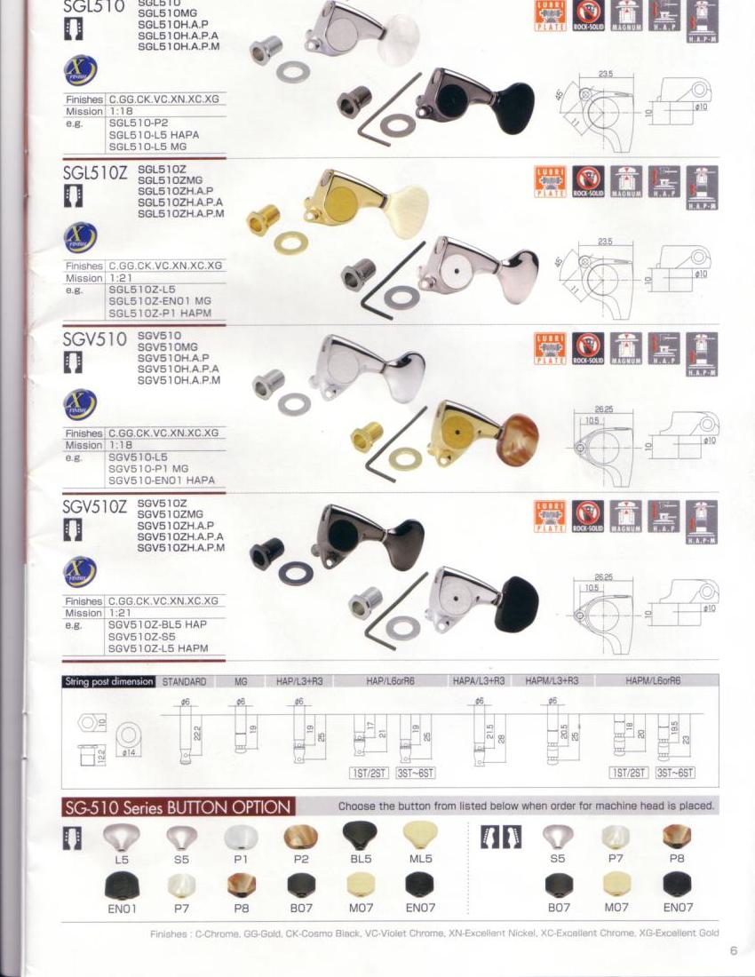

yeah. make sure you get the ones that have the screw holes off to the side.

The standard 510's drop right in, not the deltas.

You can take a look at these Gotoh catalog pages if you like. Notice the offset on the set screw. You will need one that is 11 mm from the shaft centerline at a 45 degree angle from the base. Or, take a look at your pings and you can see where the location is...

If you would like to have these permanently posted, PM me with an email address and I can email the original scans to whoever would like to put together the sticky. The pics I posted were of the 510 series. I have scanned in the open back tuner options as well as the three post classical tuner heads.
For that matter, anyone wanting these can email me as well.

They are a Gotoh dealer, but (more importantly) carry 126 different machine head tuners. However, 126 is just the number of different models of tuners, not styles of tuners. For instance, in the Gotoh 510 series he has 5 different posts, 7 different buttons, and 12 different finishes. So, in just the Gotoh 510 series you might have up to 420 different combinations. He admittedly does not carry all of them in stock, but he does have proper representation of the popular combinations from all 126 different tuners and will order anything he does not carry that is available.
He was the one who faxed me the schematics for different tuners in the series that I was looking at so I could measure them up for fit. I really appreciated the time he took with me on the telephone and I'm convinced his customer service is above par. He sent me the catalog that I scanned, and I'm forwarding the scans to Steve so Steve can put them on the server and sticky some links for everyone.

Here are the links to the scanned Gotoh catalog pages that Dale_I provided.
Gotoh 1
Gotoh 2
Gotoh 3
Gotoh 4
Gotoh 5
Gotoh 6
Gotoh 7
Gotoh 8
Gotoh 9

Edward, these are the offset tuners but have the delta 21:1 mission the center screw is a different part number, LMI puts a SC on the end Domo uses a Z. Thanks for the heads up though, with the 45% angle these should drop in. This is the detail I sent to Domo.
http://www.lmii.com/CartTwo/DisplayLargePhoto.asp?largephoto=GotohContourSSDeltasZOOM.jpg
