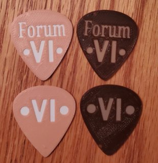

I have been working on this for a while. A few iterations of design and then re-design to accommodate the limitations of my printer. I tried several versions of this and these two final designs are what I am presenting to you.
I will custom print one of these for every original owner of the Larrive Forum VI Guitar, free of charge.
It is a simple design yet one that uses two tool changes. I could actually make these 3 colors but chose to just "Sandwich" the "inlay" material between two layers of the same color.
I tried to add Larrivee and even attempted an actual logo but it started to look too busy. The logo was not pretty. lol. I would have to try to print it with a .25mm nozzle and that can be challenging and inconsistent. At least with this design, I know that every time I print one, it will work. The surface may look a little rough in the photo below but they are surprisingly smooth in real life.
We have Terra Cotta with a White inlay and Brown with a Terra Cotta inlay. If you want one of each design, let me know which color scheme you would like for each one.
These picks play really nice. They are 1mm thick and printed using PETG 3D filament.

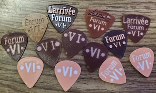

The collection of designs and printing attempts. They were getting to be over 2mm thick with the embossed lettering. It does provide a nice grip but I prefer the "inlay" versions as they don't affect the flexibility of the pick.
