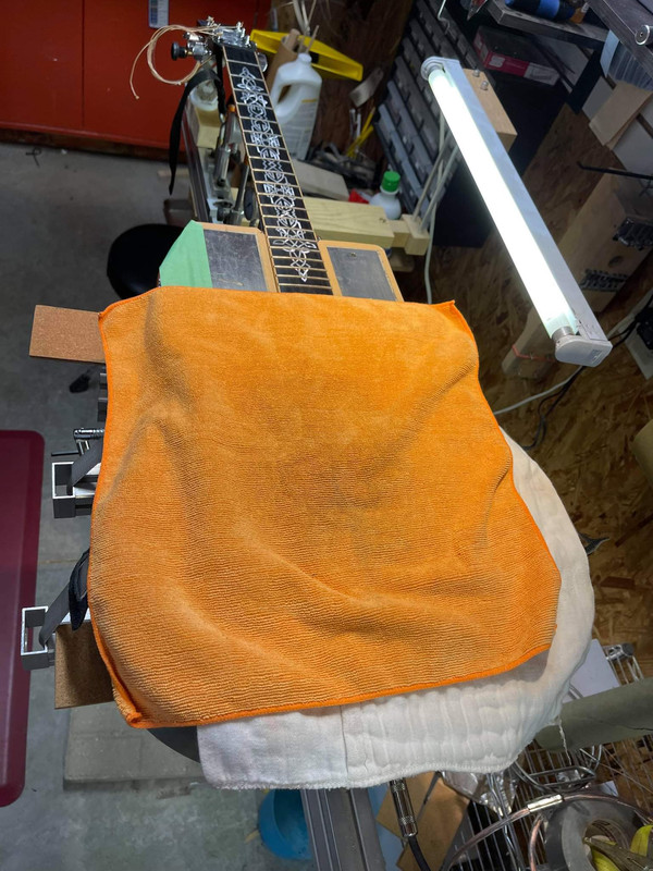

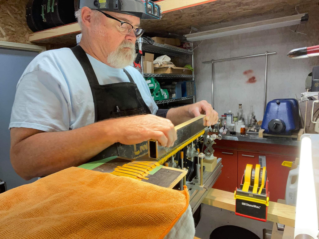

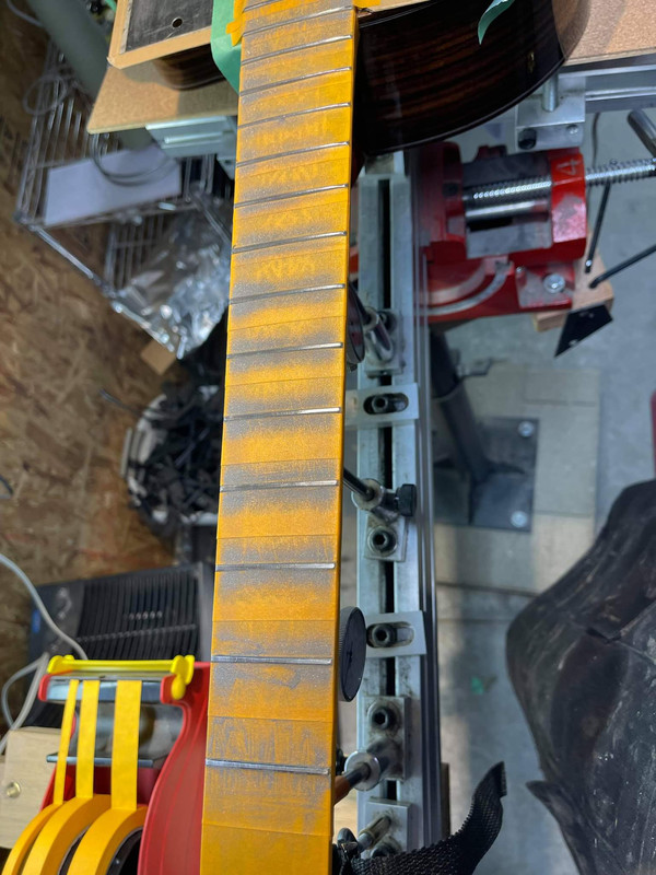

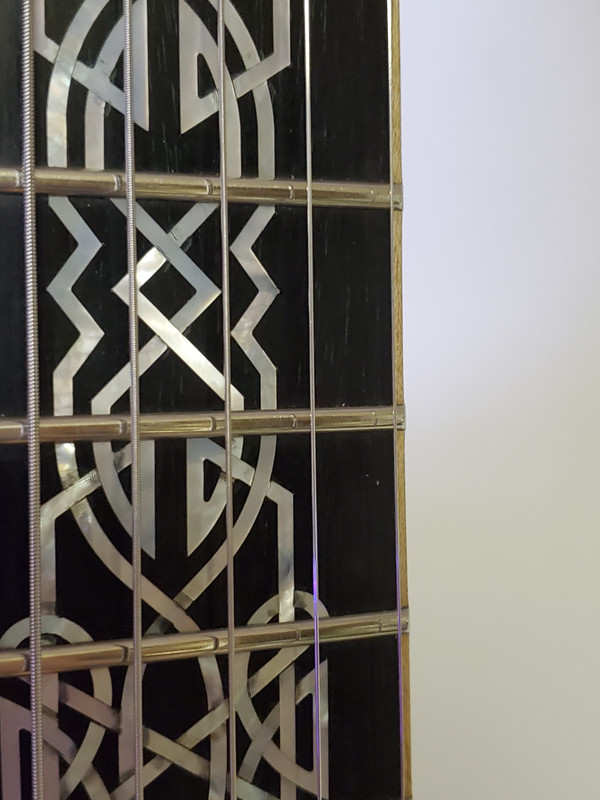

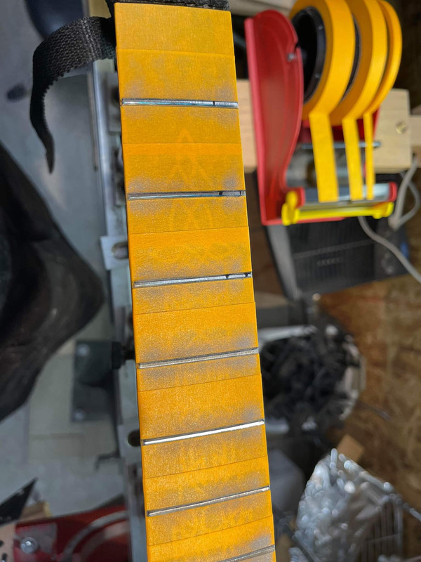

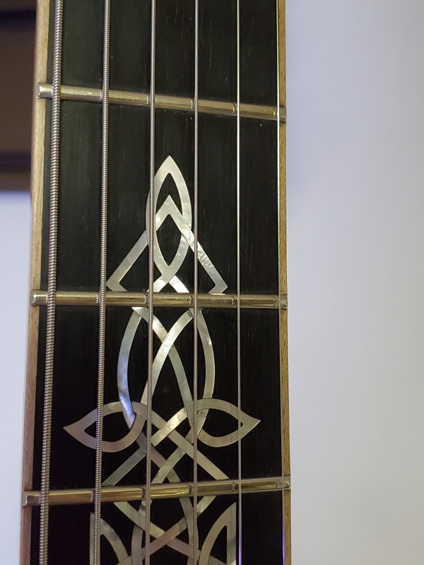

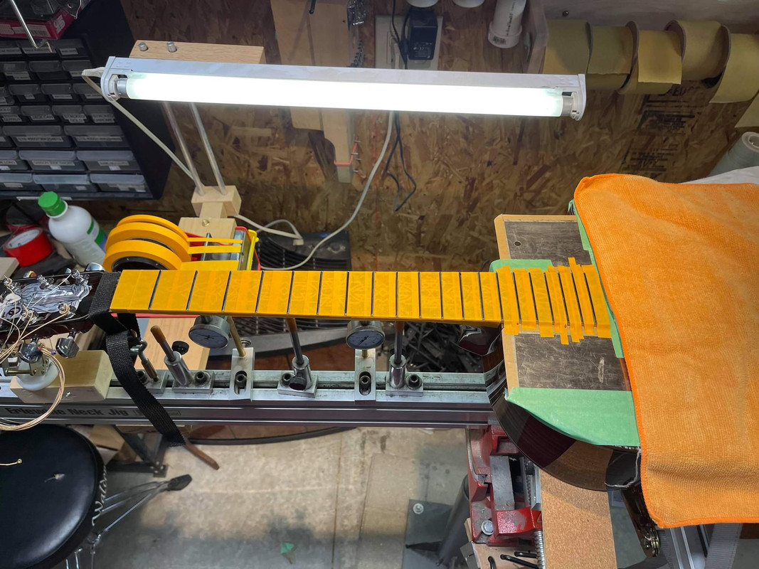

After 4.5 years of multi hour playing on a daily basis, the frets on my LV-10 50th Anniversary, needed to be leveled, dressed and polished.
More than just the first position needed this, as I use the entire neck when I play.
The technician is Bill Hatfield, of the Janesville Hatfields. He's the real McCoy.
Photos will show the extent of the wear, the process, and the results. In the final photos you can see the reflection of the strings in the polished surface of the frets.

Very nice,I assume that the black in the divits is from blackening all the frets.I don't tap off the wood when I do my work but just  beautiful work manship. bowdown
I'm not sure. I think Bill darkens the divots with a fine point marker to judge when he has taken enough off of the frets to start dressing. I will ask him.
