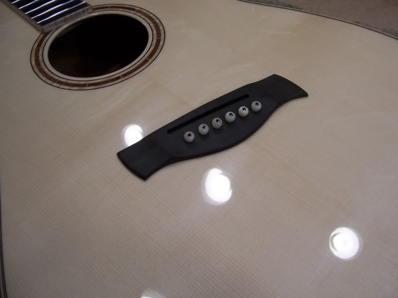

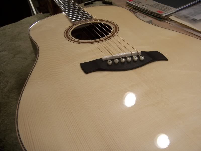

The bridge looks slanted. is that the way its being built, or is that an optical illusion?
OutWithTheBlue
Posts: 789
« Reply #106 on: January 25, 2011, 04:10:59 PM »
Slanted bridges, especially on the bass side helps with intonation and keeps the note more "true", adds more bass response too (longer string). I'd love to get me a fanned fret guitar with a slanted bridge.

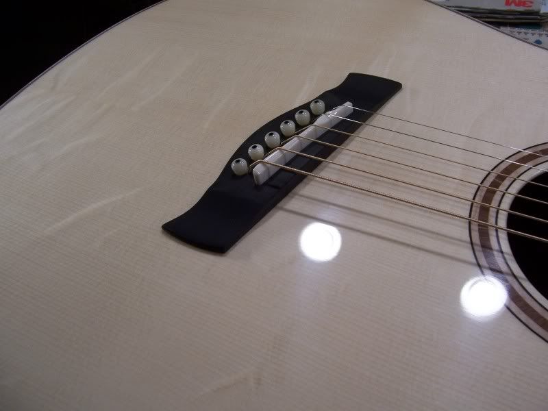

bluesman67
Posts: 3166
« Reply #107 on: January 25, 2011, 11:31:29 PM »

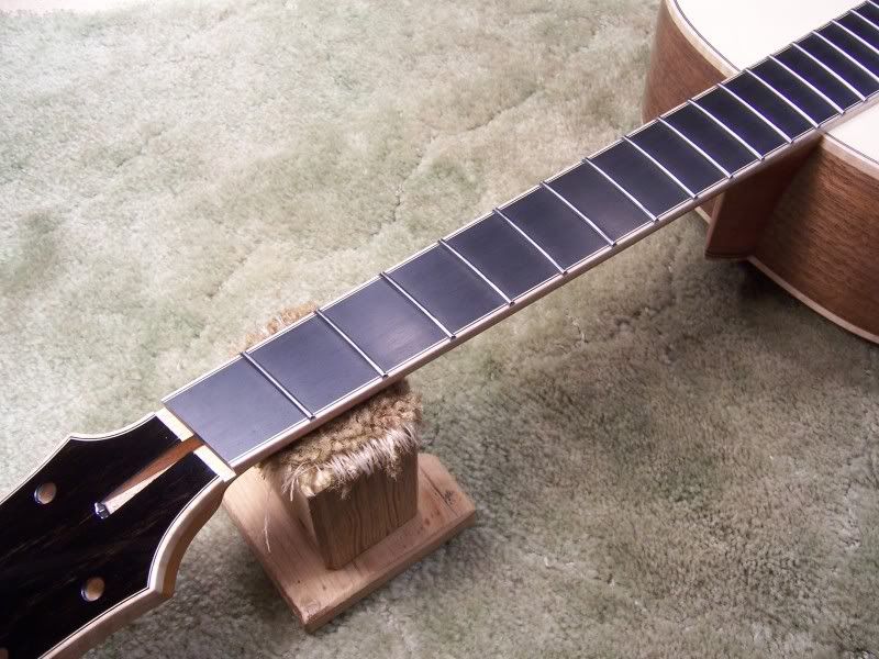

The low E scale is 25 3/4" and the high E is 24 3/4". The idea is to balance out the strings, the shorter delivering crisp and cutting highs, the longer giving a more pronouced focused bass. Multiscale or fanned fret instruments have been around for hundreds of years. Just like a piano where the optimal tone is achieved with longer length on bigger guaged strings and a shorter length on lighter strings. The frets are also fanned if u go back and look at some of the pics u will see this.
 I've had the pleasure of playing a multiscale Green Mountain for several months now, although its not mine.Glen sent it to me to help make many of the final choices on specs for my guitar, its been invaluable.
The saddle in the pic is just a blank, when Glen makes one it will be bone.

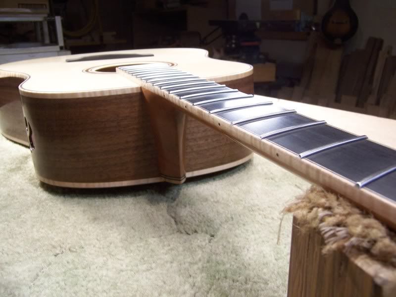

« Reply #108 on: February 03, 2011, 02:34:15 AM »

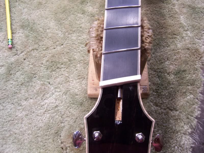

Frets gettin' polished!

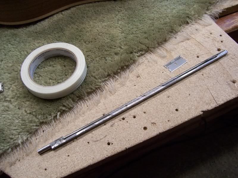

notes from Glen at GMG...I made this truss rod. I have tried to explain how these work before, to a few other folks, and I have not been very successful at it. There are the parts for yours and a sample rod. If you turn the nut clockwise, it bends the rod.
notes from Glen at GMG...At the end opposite of the nut, I put this little shim in there before I weld it. You don't need it but, I do it anyway.
notes from Glen at GMG...I put a little wooden shim in between the flat bar and the round rod. You don't need it but, I do it anyway.
notes from Glen at GMG...Put a little bit of tape on it so the shim does not fall out and the rod doesn't rattle.
additional trussrod notes from Glen...I made this truss rod. I have tried to explain how these work before, to a few other folks, and I have not been very successful at it. There are the parts for yours and a sample rod. If you turn the nut clockwise, it bends the rod.  I think that these are great. You can make them any length that you want. Some folks say not to use them because they are to heavy and they rattle. Here is yours. 106 grams.  Martin's rod is 153 grams, Stew Mac double rod. 133 grams. I think mine is light enough.
