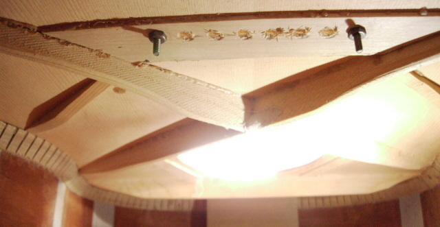

I might as well add my saga to this thread.
A few years ago I had the opportunity to buy a used SD-50 at a very good price.  It was (and remains) the best guitar I could afford, and it was a huge step up from what I owned at the time.
During the next year-and-a-half I gigged with the box and practiced incessantly.  As my skills grew, so did my dissatisfaction with the sound of the guitar.  A certain amount of "jadedness" is to be expected with any axe over time, but I was in no position to think about looking for another instrument.  I decided to try to mold the guitar into my dream axe.
My first complaint was the apparent volume of the guitar.  Despite the assurances of my bandmates that the guitar sounded fine, I didn't feel "enveloped" in the sound, and tended to thrash it to hear myself.  I carefully cut a sound port in the upper bout over the built-in reinforcement.  This was a big improvement but..
..now I felt the guitar was entirely too bright.  I confirmed this by recording myself - yup, too bright.  I wanted the box to sound as old-timey as it looked.
I read everything I could find on guitar bracing.  Lots of information out there, some of it conflicting, some just plain "iffy", but I took away two important (and fairly consistent) theories:  (1) Shorten the braces and get more volume and (2) square corners are bad.  Plus one big takeaway:  Get stupid, and you will ruin your instrument.
Over a few months I did the following, restringing and letting the guitar settle in between steps:
1.  Bone saddle.  Took several tries to find a piece of bone (from Larrivee) with the right density.  Result:  better sustain and a little "rounder" sound.  Still too bright.
2.  Changed strings from phosphor bronze to 80/20.  Result:  a fatter tone, but not fat enough.
3.  Raised the action a full eighth of an inch.  Result:  a major improvement in the sound all-around.  Wanted more bass, though.
4.  Planed and sanded the corners of all the top braces.  Did not change the height at all.  Result:  more volume, but no substantial change in the timbre.
5.  Planed an eighth off the bottom braces.  This was a revelation.  Brought the mids way up.  I felt I was on the right track.
6.  Sanded the corners off the bottom braces.  Result:  a bit rounder sound.  Just a bit.
7.  Planed an eighth off the top braces.  Big jump in volume, still a bit too bright.
8.  Sanded the corners off all top braces.  BINGO!  Following the existing contours of the braces, but taking a little meat off everything, then rounding all right-angles off, I got exactly what I wanted.  The previously weak low E now growls, the highs are sweet, not tinny, and a light touch is all it takes to get good, solid music out of the guitar.
I am a tinkerer.  I don't have a single instrument I haven't "tweaked" in some way.  I'm also foolish enough to try anything that pops into my head, if I think it will make a positive difference.
Do I recommend anyone else try this?  Heck no.  Am I glad I did it?  Heck yeah.

I'm too "noob" to attach pictures.  Need four more posts.  I'll get them up at some point.
Cutting the hole(s) was an interesting project.  I opted for a paw-print (the name of my group is Three-Legged Dog).  I cut the pattern out of cardstock, glue-sticked (stuck?) the pattern to the guitar and traced around the pattern wiith a dry-erase marker.
I then took a Dremel with a very fine bit, starting from the inside, working toward my marks.  Once I had the shapes cut to size, I used fine sandpaper to smooth the edges and lightly beveled the finish down into the holes.  Next I used a curved Xacto blade to cut away the stray fabric of the reinforcing patch, and finally stained the raw edges with some red oak stain.
