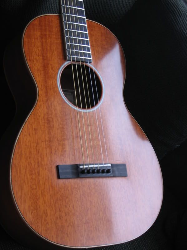

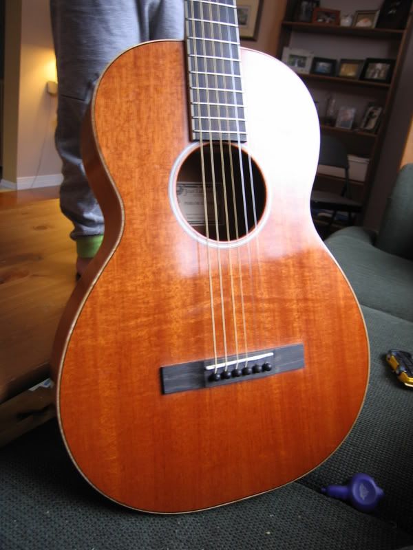

I've got the top of the all mahogany parlor all done now.  Have to do the back and sides next.  Sorry about the crappy photos.  I'll more when the back and sides are done.
What d'ya think?
first, what I think is what a sweet guitar! I'd love to get another Larrivee parlor someday. had one (spruce/koa) a long time ago. it's one of the ones I let go that I regret.
As to the gloss, looks great!  if you like it that's all that matters. For what it's worth, the process I used put a gloss, and I mean gloss like a factory-gloss, see-yourself in a mirror-type gloss finish on it. not what I expected,  especially for the level of effort I was willing to put out.

Quote from: Denis on January 27, 2007, 09:08:38 AMI've got the top of the all mahogany parlor all done now.  Have to do the back and sides next.  Sorry about the crappy photos.  I'll more when the back and sides are done.
What d'ya think?
Very nice  :drool:

I did the back and sides this weekend but didn't have good enough light to take any photos.  I'll try to get some up sometime this week.
I plan on putting on a coat or two of polish all over when I do the next string change.
