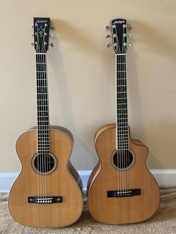

Because I can't stop myself from taking pictures today here's a std size OO next to a custom OOV that is 24.75. Note the bridge saddle difference of about 5/8" from the bottom edge of the guitar.
String tension is the least of your concerns IMHO. With an online string tension calculator you can find the tension you have now and then shop for the string guage set that fulfills your objective.
The picture will show the nut on the OOV is slightly shorter. With a gun to my head blindfolded put either guitar in my lap and I would not be able to pick which was the short scale. I measured the distance from the bottom edge of the nut to the top edge of the 3rd fret, 100 - 98mm. With only 2 mm difference across the bottom three frets I'm skeptical anyone could tell them apart blindfolded either.
That said, very subjectively, for my long fingers, I do find that with a capo on the second fret of the OOV is a nice compact fret spacing I actually prefer over the same capo placement on the standard scale OO. But I could be imagining that.
