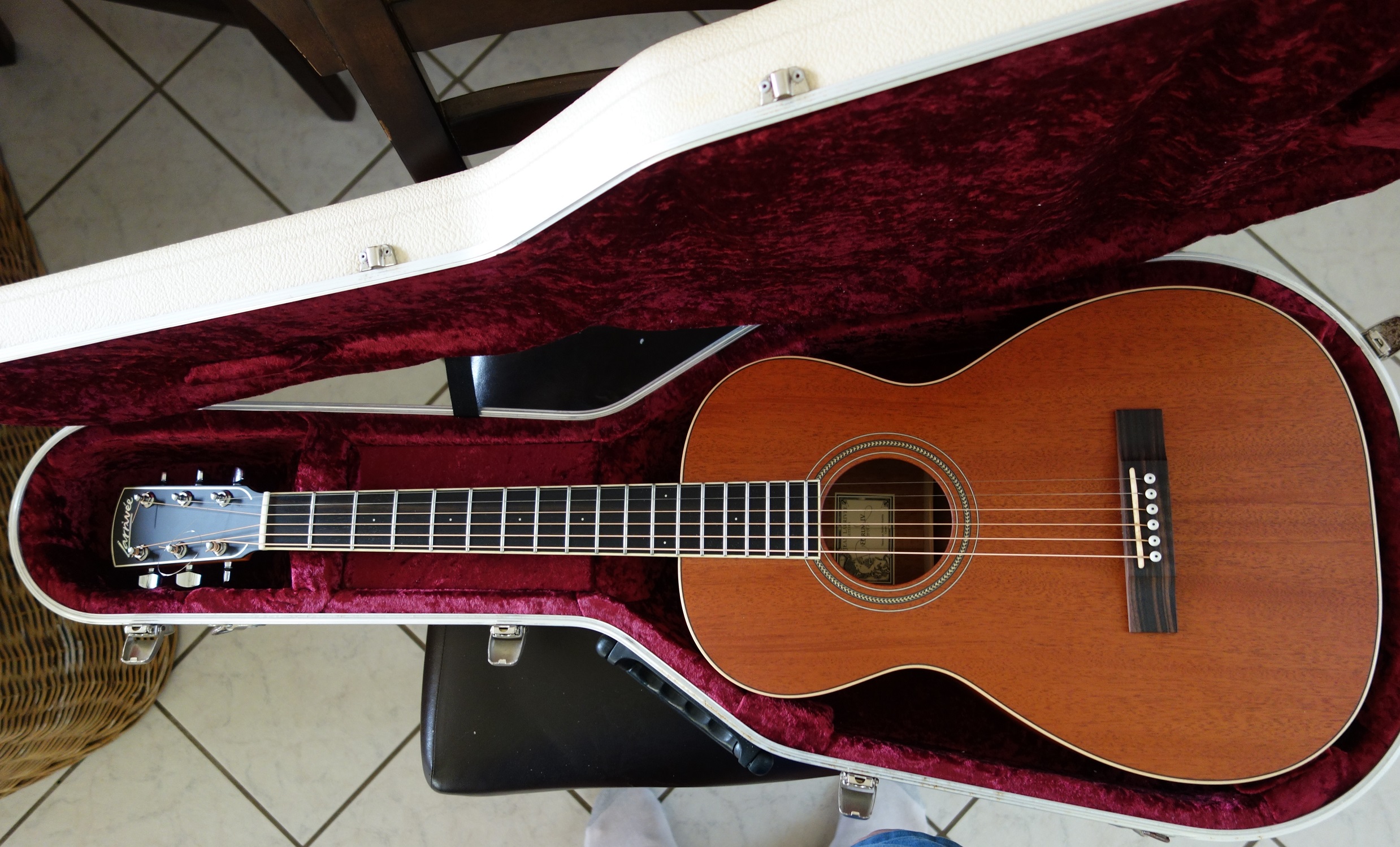

Quite a while ago I bought a Hiscox Medium Classical to use with my Larrivee OO.  The seller also sent me two small pads that I put on either side of the end pin.  The pads are made of the same material as the case liner.  If there is any foam inside the pads I would be surprised, they are not that thick.  The guitar fits in the case nicely.  Here is a picture of my Forum IV in the case.
I also picked up an Access case cover which has backpack straps and a front pocket. I've flown with it a few times and always been able to carry it on.  It used to fit in the overhead bin but I think the bins may have gotten smaller in the last few years.
As mentioned above a better case may reduce the risk of damage to a guitar, but doesn't eliminate it completely.  Depending on how often you think you will need it and what planes are involved.  An inexpensive OO or O might be less expensive, and perhaps less stressful, option .   If you need more info on the Hiscox let me know.
